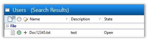

As a basic rule I think that when a file is not checked out the PDM-system always contains the truth.
(despite whatever users tend to do on their local workspace)
However Vault focusses too much on local files, this can result in dangerous situations.
Suppose you have a file which is locally changed:
There are several options to see  the document:
  • View:                   gives the version stored in Vault
  • Open:                  gives you the local version
  • Check out:           gives the local version
  • Get:                      gives the local version
  • Get\overwrite:   gives the version stored in Vault
  • Synchronise Workspace: keeps the local version (why)
If a user wants to checkout this file and doesn't pay close attention, Vault will in most cases use the local copy, which is not what the user expects. The only warning now is this green dot (with green being the worst choice of color)
My advice to our users now is to always do a get\overwrite.
Personally I'd like to have the option overwrite as a default, but at least I'd like a warning saying something like:
"your local copy differs from the Vault version, do you want to overwrite the local version?" (default: Yes)
