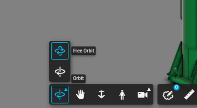

Need a way to force customization on all browsers. when you clear cache, have to re-set them up.
steveh3
"Free Orbit" needs to be the default for mechanical, it never remembers the setting...

Need ability to hide icons on toolbars for mechanical. These are not used and just confuse the users...
steveh3
In the manufacturing world most cases we use wider screens that taller taller ones. Therefore we have more empty space on sides of viewer. Would be nice to move toolbar to sides vs on bottom.
steveh3
Also, had several request to be able to remove buttons. These don't do much in manufacturing world...
steveh3
One more request is to roll-up toolbar or ability to pin it if roll-up is allowed....being able to dock toolbar on side or move around might take care of this request.
steveh3
Another request is to be able to have larger buttons on toolbar. We are using from 10" to 70" screens on production floor. Sometimes bigger buttons help the users.
