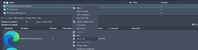

we are using AutoCAD Plant 3D with vault Professional 2026. Because Plant 3D settings are stored in .xml and some must be managed manually by opening .xml and chaning it. I would like for some users to be able to check out the .xml file directly from vault client and after changing it save it and then check it back in. Currently check out works, but the check-in doesnt work. There is no warning or error pop up. Also new version is not saved.
Can anyone please help me understand, are there any restrictions for checking in .xml files or something similar or are we doing something wrong.

Is there a possibility to vault working differently if this xml files are plant 3D projects files?
Here are some screen shots what is going on:
Check out works normaly
But when I try to make check in nothing actually happens
no new version is checked in, page does blink as a refresh but that is all it happens.
Did manage to get a bit of a workaround and check out the file in vault client, edit it on local working folder save it and then open project setup in plant 3D and just close it back down. That somehow makes a new version on the vault but I would really like to manage the xml separately.

According to your images, you didn't make a change to the XML file. The icon next to it is still white with a check-mark.
Make sure that icon turns green with a check mark and then check in the XML.
If it is not green, Vault will perform an Undo Checkout because no changes were made.

thank you for a reply. I tried now to check out file, make some changes, save file and it did turn green that check-mark.  The check in worked for making a new version on the server but the file was left checked out. After that just undo check out will remove the file reservation. Its not ideal but manageable.
