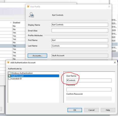

In Vault Pro 2022, it appears that the "Change Password" has been removed from the User Profile when accessed from the User and Group Management window. Is this an oversight or by design?
If by design, how can the administrator reset the password for a user?

Click on Accounts, then select Vault Account (already set, but click it anyway).  The password reset is in there now.

I would have NEVER found that.  Thanks.
karthur1
I just noticed that in order to see the username associated with each account, you have to go to the same location.  I really wish they would have left this on the User Profile dialog.
