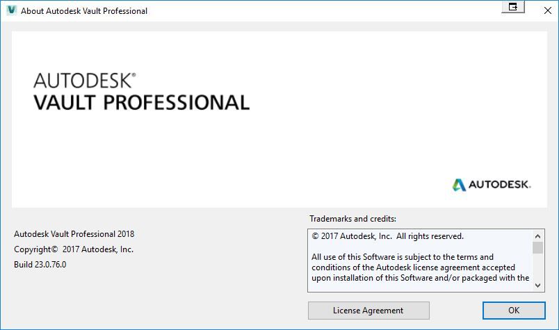

Software Overview:
Vault client build: 23.0.76.0
Inventor Pro build: 227, Release 2018.2.3
Windows 10 64 bit.

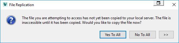

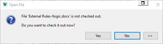

I'm not sure what he did, but after doing the rename to our development server we are not able to obtain any of the IV files from the newly renamed server.
All of the files show the current owner as the previous name of the server.  Not the new name.
The IT guy tells me that the problem is on my end and that he's followed the appropriate steps while doing the renaming of the server.
I've attached three images of the three dialogs which appear when any file opened from Vault.
