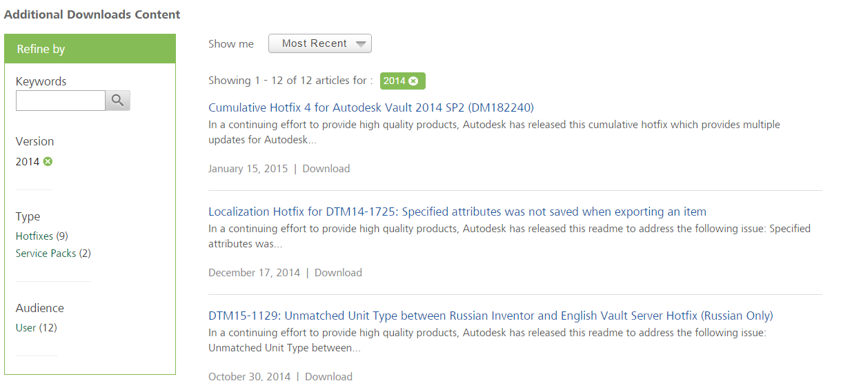

I can not see a hotfix  DM182241 on the Autodesk Service & Support website and also not in the Autodesk Subscription Center.
The latest hotfix that is visible for me is  DM182240 as shown in the attached screenshot (order by most recent hotfixes in version 2014).
Also a google search returned no result.
can you give me the link to this hotfix - why is it not officially listed on the website? Why am i too stupid to find it Smiley Happy ?
