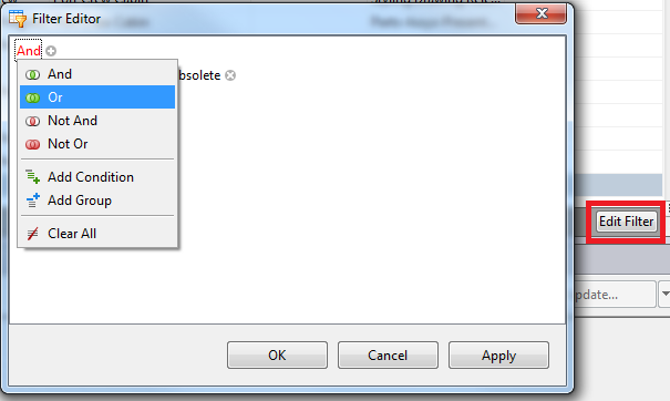

FYI regarding the Filter you can set other operators by selecting edit filter, once you have setup a basic one.Untitled.png

Wow, This screen shot shows exactly all boolean operators I was talking about. Is this in the screen shot from within the search dialog?
I am very curious to know from which part of the vault, you could go to this edit filter?
Please share this info.

Check this screen capture out http://screencast.com/t/2AS5AtFW3kF
and then this one http://screencast.com/t/unGOvpOE4Cga

This is great ! These searches are performed on the results or inside of a folder. It would have been nice if we could have saved them. Any how, this is great and very useful.
