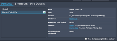

I've just recently released all parts to a project with different categories but now have an issue with managing project files. I have eliminated the extra project file paths from the home screen, such that the default and company projects are the only available files. However, I cannot resolve the file as the project file is read only. Is this an admin task? I have checked out the assembly but cannot reacquire the necessary paths. I can also confirm the active project file is in my workspace and vault.
i have found checking back in the assembly, having inventor opened at home, then opening the assembly from vault clears the error. Is this intentional or is there an error in the program?

I do not use the update command for the view tab at all. For deleting the entries, would these be the temporary ipj's, or another prompt?
Message 10 of 11
ihayesjr
Are you pressing "OK" when you see this prompt?
Irvin Hayes Jr
Principal Product Manager
Autodesk, Inc.
Vault - Under the Hood Blog
Message 11 of 11
playQGM8B
I clicked ok when it did prompt. I removed the extra project files and only have these available. The prompt no longer displays when attempting to open a file.
