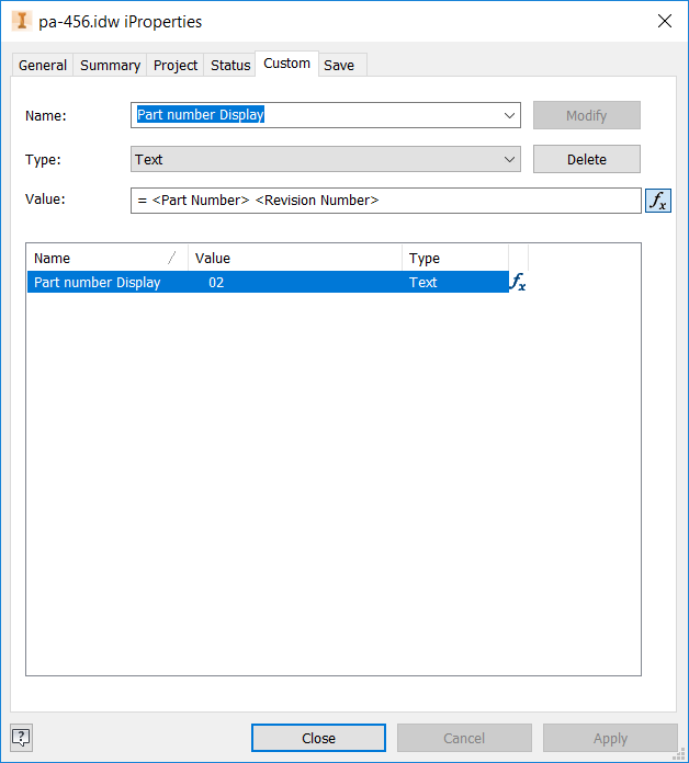

Not sure if this will prodcue exactly what you want but you can use functions in iProperty boxes by placing an equal sign in the value and then enclosing the desired property in the < > brackets. I am showing a custom iProperty created which concatenates the Part Number and Revision iProperties.
II then placed the custom iProperty into my Title block and got the result shown below.
You can find a little more info on using the iProperties in functions here.
