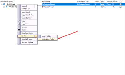

I know I am lazy, but: Sometimes I use Copy Design to copy some documents into another folder. I would like Vault to jump directly to the destination folder when the copy action is finished.
I know that Copy Design is technically a separate application. But maybe the jump is possible when I start it from inside Vault?
Also, if I copy sub-components to different target folders it becomes difficult. Then I would like to go to the destination of the main assembly's copy.
Lastly there is the case when I copy several unrelated files in one go. Maybe got to the first selected one? (Is that option much used anyway?)

I moved your post from the Ideas board to the discussion forum because your idea is already possible.
After the Copy Design is complete, select Go To Destination Folder after right-clicking on the file.

Ouch, this happens if you don’t try out all of the Options & Buttons. Could archive the idea please?
