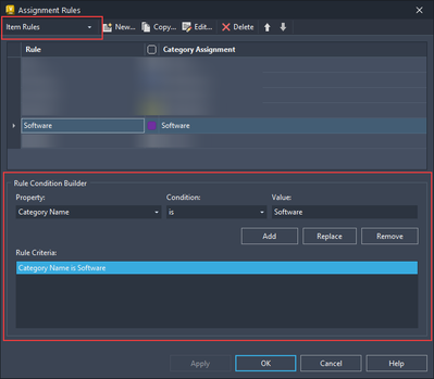

sbrandsen
Thanks for the reply,
Unfortunately it seems like it does not look at the FILE category at all:
I've set the file category to Software. Then with the rule read the Category name Software.
But I think when assigning it looks at the Item Category Name, not the FILE one...
This results it my default category, which is Part Item
ihayesjr
@sbrandsen
You will not be able to perform what you are asking for files which Vault cannot read file properties.
I will try to explain.
Vault has what are called Property Providers. These providers enable Vault to ready standard and custom properties inside of the file. For your Zap file, there is no property provider and therefore it can't ready any of its properties.
As you have already tried, the Item rule is only going to look at Item properties to set the category.
You would have to push a file property into the Item property for it to run the rule and set the category you want.
For example, Vault now has a property provider for PDF files. You have the ability to push the PDF file property into an Item property. Then create a rule which looks at the Item property and set the category.
In my example below, I am extracting the Title property from the PDF into the Item Title property.
Then I created a rule that looks at the Item Title property for containing "pdf."
I make sure that the Title in the PDF contains PDF and assign the Item.
The assignment then sets the proper category.
I cannot do this for a JPG, because there isn't a JPG property provider.
