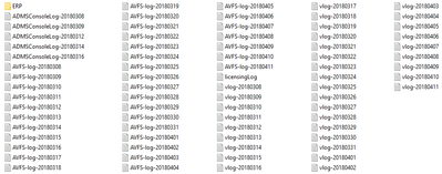

Hi @JasonDai, i already have the log, but is huge, there is a list of files into that folders, and i really don't know what Im looking for.
There ismore than 2Gb of files, i'm already try to read some files, i can found nothing suspicious.
 In this link https://autode.sk/2EGOJgd have all log files.
Thanks for the help guys.

I see 14 SQL timeout errors in vlog-20180409.txt, which is the log of the day you posted this problem. That should be relevant to the performance issue. Please follow below steps to increase the timeout limits--
