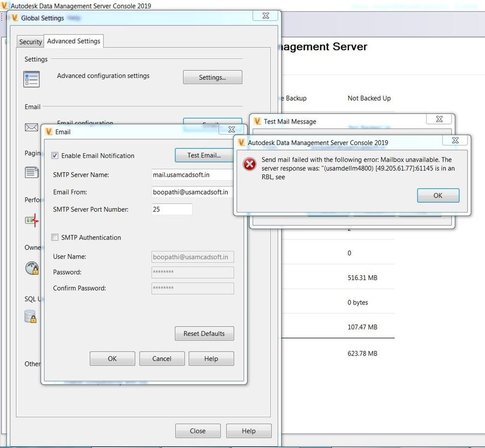

Hello guys,
Have problem while configuring email in Vault 2019.
Do no whats the issue while configuring it says operation has timedout as shown in the image
kindly help me with this
thanks
Boopathi

cbenner
@Boopathi_Sivakumar
Have you tested that port you are using to make sure it is open?  That could cause a time out error, because the server is trying to send the email, and it cannot get through.
Another thing to check, are you using Windows Domain credentials for your Vault logins?  If so, you may not need to use the SMTP Authentication  in the Email setup dialog.
ihayesjr
Looks like you are using port 465 which may be a secure port. At this time Vault doesn't connect with secure ports.

Boopathi_Sivakumar
After Checking with my server settings in my mail I tried this it says SMTP AUTH is required i have checked in i have given my username and password correctly but still got the error what should i do now?

Boopathi_Sivakumar
That too not working this time some other pops up.

Hi @Boopathi_Sivakumar
The error message being displayed in the ADMS Console, is being handed to it, from the email Server itself. Its not Vault that is erroring.
If you look at the error message "61145 is in an RBL". I do not know what software is being used for the email server, but I suspect that RBL, stands for Real-Time Blacklist.
So work with the email servers Administrator to resolve that specific error message.
