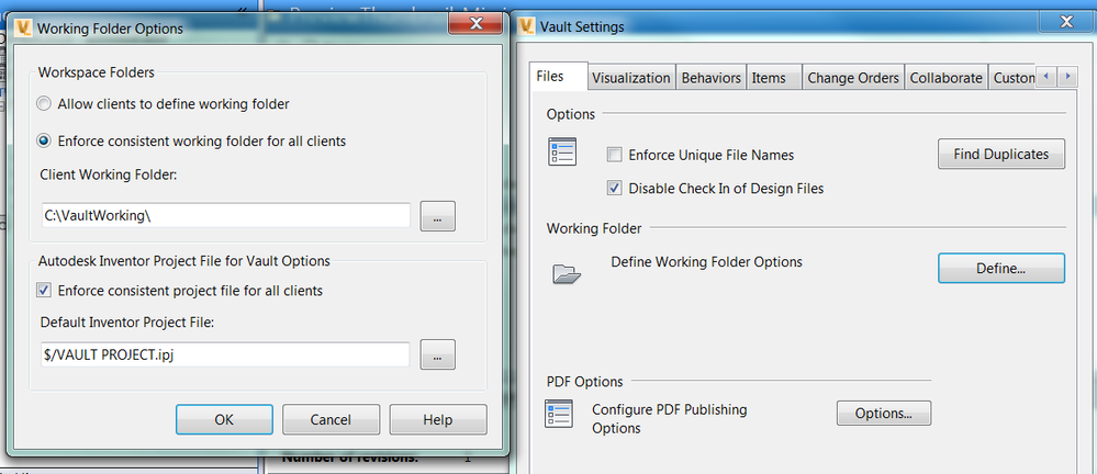

When we check out through Inventor or the Vault Add-On in Inventor it creates the correct file path and folders, but when we use the Get function in Vault it creates a duplicate folder inside of the working folder on the hard-drive. (See photo)
We need the Get function to go back to previous versions, but like I stated earlier it creates duplicate folders, so then we have to manually move the file into the correct folders and file path on our hard-drives, that it would be in if we had checked it out through Inventor or the Vault Add-On in Inventor. This can get crazy really fast, not to mention it can cause issues on the check in, do to the name already being used in that folder in Vault.
My question is, how do I fix this problem so that when the Get function in Vault is used it puts the file in the correct location on the hard-drive, whether it is a previous version or the newest version? I was wondering if it would be a good idea when we update to the 2019 version if we started from scratch in a way, put all the files on an external hard-drive, then install a new Vault with all new Working Folder and path structure. Then start checking files in, while getting rid of duplicates at the same time. Is this a good way of fixing the problem?

@Anonymous I wonder if in all your Inventor project file reorganization that some end users may be using a different project file from others or that the defaults in Vault Client are not set as you would want.
Have you confirmed that the active project file in Inventor is the same as the default project file used in Vault client (Vault Client > Tools > Options)?
And what are the Working Folder Options you have set in the Vault Options (Vault Client > Tools > Administration > Vault Settings > Define Working Folder Options)? Is there a discrepancy where the GET from Vault may use a different path compared to the working folder from the project file active in Inventor?
