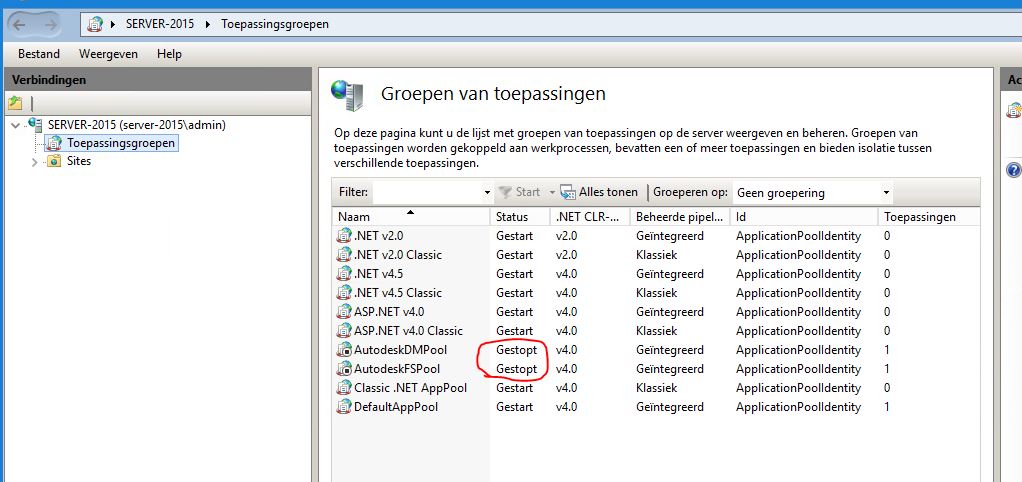

Last night our vault server updated to the windows 10 fall creators update.
Now we can’t access the vault.
It gives ‘Vault Basic 2018 could not find the Data Management Services on <server name>’ as an error-message.
When I try to backup the vault, ADMS gives the error ‘Failure calling web services on 'http://server-2015/'. See log for details..’
In the IIS Manager I can see that AutodeskDMPool and AutodeskFSPool are stopped. I don’t know if they must be running. If I force them to run, they will stop again immediately.
I’ve tried disabling the firewall and McAfee Total protection.
Does anyone have an idea how to fix the problem?
