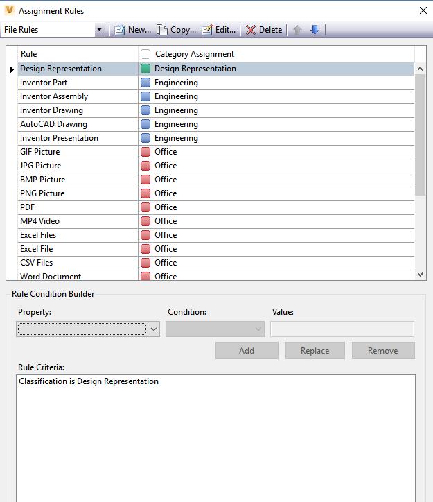

Inside of the Vault Settings -> Behaviors -> Categories -> Assignment Rules, make sure you have a rule configurated that will look at the property value and assign the category properly on Check-in. Also, check the box "Apply rules on object creation."
Slight correct, make sure there is an Item Rule that looks at the property Type is Purchased is there to assign the part to the Item Purchase category.

Please find attached print screen files of the Assignement Rules. I am not sure is properly configurated...
I would like to configure that first as you propose, but I don't know exactly how to check.

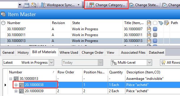

To change the category manually:
- select your Item (either in the Item Master grid or in the BOM of its parent item)
- call the function "Change Category" which is on the icon toolbar or on the "Actions" menu
- then you should be able to select the new category in the drop-down list
NB: your user account in Vault must have the correct authorization (through its role) to change item categories.

I did as you say. I still have "Part" when I attempt to export BOM.
