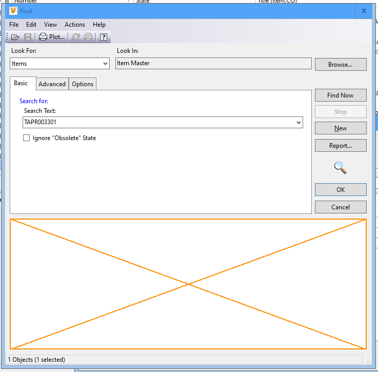

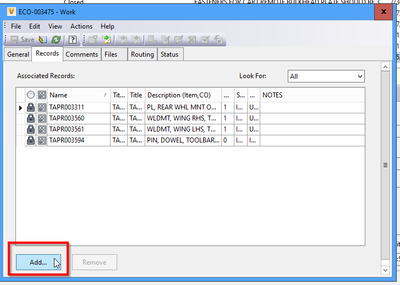

When adding an item to an ECO, the search tools results grid fails to generate and the result field displays an orange X, then Vault immediately crashes.  It now happens every time I try to add an item, restarting Vault and the computer have no effect. I've tried it on multiple ECOs and with multiple item numbers--all have the same behavior now. This has essentially made me dead-in-the-water and unable to use our ECO process.

I did some tests and discovered that if I search for a string that couldn’t be related to any item (e.g. “ASDFASFASFASFASF”) it won’t crash, it’ll just say “no items match that criteria”. However, if I search for something like “123” (which could be in the name of many items) or a specific item, it will crash.
So it clearly has to do with populating the search results, not the actual search function. Which makes sense given the big X in the window.
