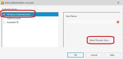

So I found a fix or at least one that's now working as the first couple attempts, it failed.
But yes, no autofix, I am having to edit each user's account once they have been migrated to the new domain.
Process:
In Vault as an Admin, Tools > Global Settings > (Users and Groups) Manage Access
Select the user > Select "Edit" > In the User Profile pop-up, select "Accounts" .
In the Add Authentication pop-up menu, make sure "Windows Authentication" is checked/active. Select "Select Domain User..." button on the right side.
Select the "Locations..." button and select the new domain from the list > select "OK".
Type in the users name in the "Enter the object name to select" field and the select "Check Names". Select the user's name from the list and select "OK".
Back on the Add Authentication pop-up menu, select "OK". A progress bar will pop up then disappear once done.
Close the User Profile menu and you should be good to go.
