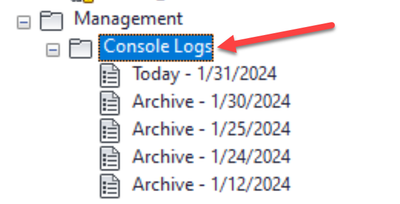

Those errors would not be related to you missing your Content Center Libraries.
The Job Dispatch Service runs server tasks locate in the Tools -> View Server Tasks dialog in the ADMS Console.
1. If you were only missing libraries, you could have re-attached the libraries without restoring a backup.
2. If the libraries were missing in the ADMS Console, you can look in the Console log to see when they were removed.
Check your Backup script to see if there are commands that remove the libraries.

Thank you for pointing me to the logs.  That is exactly where I was needing to go.  As I said, I tried to re-attach the libraries but I could not find them.  It has been forever since I have tried that so maybe I just didn't remember where to find them or something.  I will have to experiment with that this evening.  Regardless, something still happened that caused this issue and the logs are helpful.  Yes, our script does detach and re-attach our libraries.  I am not sure why we did that as I assume I can do a backup without detaching and re-attaching the libraries.  If you agree with that, I will look into doing that.  Back to the problem at hand.  I compared this mornings log file with yesterdays and there is definitely some interesting things to look at.  The first thing I noticed is the time differences.  For example, yesterday, it only took 14 seconds from when the log started to get to the point of detaching the library where as this morning it took 21 minutes and 20 seconds to get to that point of the script.  I have no idea why that would be.  They should have been relatively the same.  Any way,  this morning when the script got to the point of attaching the library I see an error:
1/31/2024 1:28:17 AM Attaching database... 0/1
1/31/2024 1:30:28 AM *******************************************************************
Warning: Detaching database AI2021_Bradbury failed
Exception: ALTER DATABASE failed because a lock could not be placed on database 'AI2021_Bradbury'. Try again later.
First thing I think is odd is it said it was Attaching the database, but then the failure says "Detaching"
I have gone ahead and copied the logs into a word document and attached.  If you could look through it and tell me exactly what could have happened that would have caused this, that would be great.  I see that at one point it gives an error message about the sa login so I don't know why that would be either.
