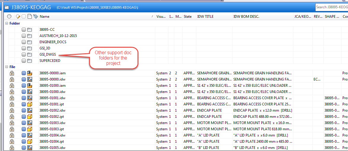

As an 'engineer to order/job shop' business we don't use Vault numbering schemes for the parts we make, but we do use them for CC and FG and Bolted Connections and the like.
Our file structure is XXXXX-YYYYY. XXXXX = the project number e.g. 38095 which is the container for all of the project details, the purchase orders, the cists, etc... YYYYY is the CAD file structure.
We make a folder called 38095-DEBTOR where debtor is the customer code from our accounting package. Inside that folder are all of the CAD files in the same 10 digit format, so 38095-00000 is the top level assy file, 38095-01000 is the 1st child assy of -00000, -01001 is the first child part of -01000. 38095-02000 would be the 2nd child assy of -00000, -02100 would be the first sub-assy of -02000, -02101 would be the first child of -02100. This gives us plenty of room for even very large projects. We have never yet run out of numbers even on 30000 part top level assy files.
The folder structure looks like this :-
38095-DEBTOR
   38095-CC
   38095-00000.iam
   38095-00000.idw
   38095-01000.iam
   38095-01000.idw
   38095-02000.iam
   38095-02000.idw
   38095-02100.iam
   38095-02100.idw
   39085-02101.ipt
   38095-02101.idw
The 38095-CC folder is a container for all CC anf FG and Bolted Connections and Design Accelerator files, as do phantom parts and FG sketches and the like, most of which use a Vault numbering scheme which directs these files to a lifecycle scheme. This folder/file structure keeps the project folder looking lean and mean as we only see the important data, the stuff we make. All FG member sand CC parts are saved as Custom and put into the -CC folder to keep them out of 'general population' as they rrely need to be seen.

Finding things in Vault is a breeze. As each project gets a specific folder the data for that project is in that folder. We then search by Title and Description for what we are looking for. We also have several Custom Views in Vault to simplify things such as a Sheet Metal part filter than only shows all of the parts created with the Sheet Metal.ipt template (whicis 60% of our business so very important).
