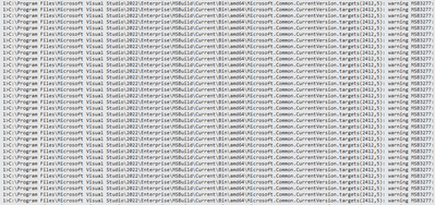

I swapped out the 2023 SDK dlls to the new 2025, and I got these errors.

I assume you have followed up with the suggestions in the Microsoft documentation on error 2412,5. What kind of Vault application or extension are you upgrading? Did you update the ApiVersion attribute from 16 to 18? If your application is an Inventor or AutoCAD add-in extension, you need to reference the .NET core versions of the SDK libraries.

Yes, I was upgrading Vault Extension api version from 16 to 18, along with Vault Professional 2023.4 to 2025.2, and Custom Job Processor too. I already did the upgrade our Inventor Addins to 2025 with .NET Core 8.0 last month.
This error is fixed by twisting <runtime> in the app.config file, and in my case, my current VS project didn't have an app.config file at all before, so I had to manually include it in.
