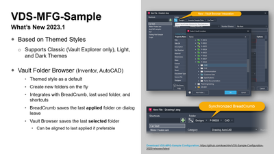

We recommend running Inventor-Vault with a single project file (set enforce option in Administration!). We can create a new folder on the fly. My published extended sample demonstrates this extension:
You can access the sample for 2024 (change the release number to access 2023 or 2025 (to be released soon): Releases · koechlm/VDS-Sample-Configurations-2024 (github.com)

Installation is straightforward. Backup your configuration files and expand the archive packages provided in the release section. I am not sure that I will finalize 2025 this week. VDS Tutorial files are also waiting to be updated for 2025...
