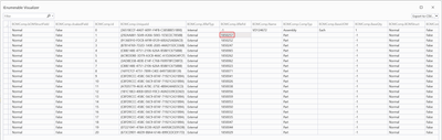

Issue: Different Properties received for single selected file versus same file as component in Assembly
When we select single File (240189.ipt) in Vault, we get correct File properties:
Vault:
Code to get Properties if selected PART:
PropInfoArray:
In this case, the Part Number (PropDefId = 26) is 240189 which is OK.
If I select Assembly, which has this File 240189 as a component, we get wrong data…:
Vault selection:
Code to get the ChildFiles for the Assembly:
Received bom object:
bom CompArray:
BOM InstArray:
The code to check the Assembly is calling the same function isValidProperties… but the received data for the Child Part are different:
PropInfoArray:
It is mainly the Part Number and Category Name we have trouble with… but probably not limited to these.
It seems we are receiving different BOM InstanceId or XRefId (1880778 versus 1850257), but how to get the same Instance from the Assembly file…?
Are you able to help? Thanks
Nick_Hall
Hi Petr
Without having access to your Vault I can't be 100% certain about this, but I think that your assembly is referencing an older version of 240189.ipt
There are loads of ways this could happen, so it's quite plausible/likely
If you want to get the latest version, you can use GetLatestFilesByMasterIds or GetLatestFilesByIds
If I've understood correctly, you want to pass an array of CompArray.XRefId to GetLatestFilesByIds, which will give you the latest version of all the BOM Components
It will get a bit messy handling the referenced and latest components, but you should be able to work it out
But it's worth looking into why this is happening, which you can do by cross-checking the version numbers in Vault, and working back from there. It may be that you need to make changes to your workflows and/or lifecycles to ensure the data in Vault & the data in your ERP system match
