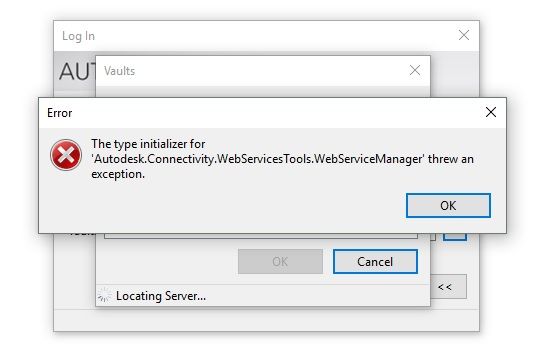

So when I fire up the application the Vault login screen comes up like it should. But when I try to log in it just sits there and tries to connect until I cancel it. If I try to browse the "Vaults" on the server I get the following error.
I did find a knowledge base article about this error and it said to delete a restrictions folder in the programdata folder. I do not have a restrictions folder there.

Hi Chad,
The code looks fine, but Vault 2017 is using a new licensing mechanism called Clic. You can read more about this in the Vault SDK help. Did you install Vault SDK? There are some samples in there as well. The VaultBrowserSample might get you started.

Hi Chad,
I did a quick test and had the same exception popping up. Adding a reference to 'Autodesk.Connectivity.WebServices.WCF' fixed the issue.. Don't ask me why though.. 🙂

Hi Chad,
Thanks for the kudo's :). It's probably because you referenced the Vault dll's from the Vault SDK folder instead of copying the dll's manualy to the ouput folder of your application. If you remove the reference to Autodesk.Connectivity.WebServices.WCF and make sure the Autodesk.Connectivity.WebServices.WCF, Autodesk.Connectivity.WebServices.Interop and clmloader are located in the output folder it should also work.

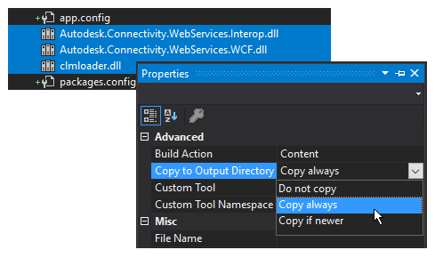

Boorda
I realize this is an old question, but just in case anyone else is wondering the same thing as @jlane  .....
Like @psaarloos mentioned you don't need to add a reference to the Dlls in your project, but you do need to make sure they are in your project and copied to the output folder during a build. In order to make sure the Dlls are copied to the right place even when changing the build from Debug to Released etc.. copy the files to the top level of your project. Putting them in a sub folder of the project will cause them to be copied to that directory under the root output directly and they will not work. Once you've added the files you need to select them all then change the "Copy to Output Directory" option in the file properties to either "Copy Always" or "Copy if Newer".
There are other ways to do this using the Post Build Events and XCOPY, but this to me is the easiest method.
