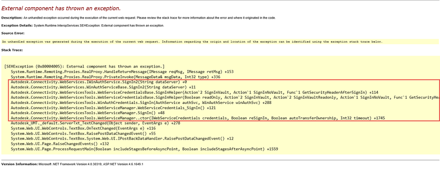

Hi @Jason.Courtemanche,
I have followed your instructions to analyze the network traffic, but I don't get any relevant stuff that can help me to solve this.
I have done more test on IIS and the last error that I obtained is the next:
How you can see the error show me the reference Autodesk.Connectivity.WebServicesTools.
I was thinking that maybe could be a corrupt library, but I have reimported all libraries and always get the same error.
I hope that you can help me with this more specific error.
King regards,
Jonathan

I tested directly on the IIS server the same application using Autodesk Vault WeService, I made different configurations in order to get success in the use of professional license, but I still getting the same error:
Exception of type 'Autodesk.Connectivity.WebServices.VaultLicenseException' was thrown
1st Configuration(SUCCESS IN READ ONLY MODE😞
The platform of the application was x86, for this case I set the option Enable 32-Bit Aplication from application pool in true.
I published the solution in read only mode access with the next configuration:
  • <Licensing edition="None" />
  • AccessWindowsAuth = new WinAuthCredentials(identities, "DATABASE", true);
    webservicemanager = new WebServiceManager(AccessWindowsAuth);
And with this configuration I could obtain the information and displayed in the website.
2nd Configuration(UNSUCCESSFULLY WITH PROFESSIONAL EDITION😞
So the next step was trying to use the Professional license in order to write or modify information, for this I use the same configuration but in this case set the license to Professional edition and disable the read only mode:
  • <Licensing edition="Professional" appPath="C:\User\Projects\AUTV\SOURCE CODE\Autodesk_APP\Autodesk_APP\bin\x86\"/>
  • AccessWindowsAuth = new WinAuthCredentials(identities, "DATABASE", false);
With this configuration I obtain the error of license:
Exception of type 'Autodesk.Connectivity.WebServices.VaultLicenseException' was thrown.
3rd Configuration(UNSUCCESSFULLY X64😞
Another test that I did was change the platform of the application from x86 to x64 and changed the DLL's files and al configuration related with platform.
I executed the applcation locally and works fine, so I published it in the server and for that I set Enable 32-Bit Aplication from application pool in false and the application runs fine but when I tried to connect with the server I git the same error from license:
In this case I changed the platform, thinking in maybe had been a issue with the license compatibility, but it was not like that.
The Vault version in server is: Autodesk Vault Professional 2017.
I don't know if I missing something for that my application can works.
