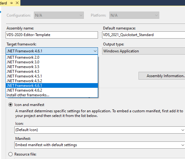

When starting the VDS-Configuration Editor in VS 2017 a message message below appears.  When I download .NET Framework Version 4.7.2 and install, the message indicating that version is already installed.  How do I make VS use the installed Version 4.7.2?
Message 6 of 12
Markus.Koechl
It should accept the shown option: change the target to 4.6.1. By selecting this option you can open the solution. Then open the project properties and change back to 4.7 or 4.7.2.

Sorry, I haven't been precise enough: open the project's properties to change the version. Your .NET message lists it anyway saying, "The C# project "VDS-2021-Quickstart-Standard"...."

Open the Solution Explorer, navigate to each of the listed projects, and right-click to select Properties. On each project, select the .NET version as shown here: 2021-03-18_00-34-53.png

This is the location I have been at before and not been able to progress further.  .NET Framework above 4.6.2 are not listed shown in Figure 1 and when I try Install other frameworks... the .NET Framework web page is launched.  When I download the .NET Framework  version 4.7.2 shown in Figure 2 and launch install, the message shown in Figure 3 indicates ,.NET Framework 4.7.2 is already installed, yet it is not listed under Target framework combo box.
Is related to using Visual Studio 2017?  Should I install VS 2019?

I hope you understand that I can't provide 1:1 support on setting up a Visual Studio environment. The Microsoft knowledgebase lists several reason/solution entries on this, like installing the latest updates on VS 2017 and/or checking the target architecture/environment PATH variable.
Upgrading to VS2019 might resolve the issue quicker as it uses 4.7.x as a base AFAIK.
