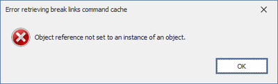

When using IExplorerUtil.UpdateFileProperties() to update properties, an error is being thrown: “The given key 'EditProperties' was not present in the dictionary.”
I am using it the same as in 2025 which works ok. Anyone else had this? I also get this message pop up:
952 Views
1 Reply
Reply (1)
Markus.Koechl
I am sorry for the inconvenience. There is a known issue; see also thread: Solved: Error when using IExplorerUtil.UpdateFileProperties from within job processor extension - on....
