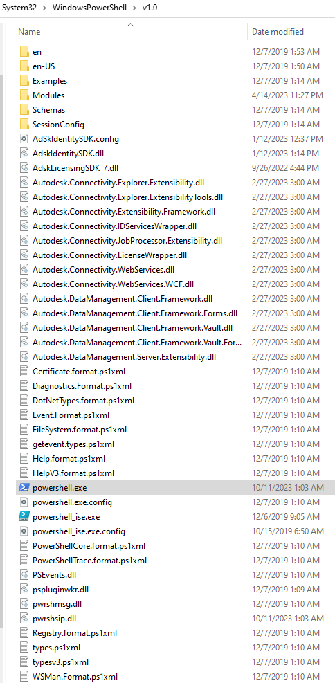

I have dropped the other 2 files and even (just in case) all other Autodesk.*.DLL files from C:\Program Files\Autodesk\Autodesk Vault 2024 SDK\bin\x64 folder to the PowerShell folder and still having same error...
Here is a screenshop of my PowerSell folder:

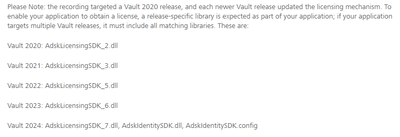

Hello @jbetz42. We regret seeing your frustration. I acknowledge that we should enhance the accessibility of documentation and samples and best aggregate federated sources. As a first step, I recently posted a series of articles targeting this on the official Autodesk PDM|PLM Blog, tagged with Vault Customization. Now, you might shout at me to start another location to search for information about Vault programming. Yes and no - yes, it is a new link. No - it matches the overall Autodesk documentation scheme, which has product documentation, a knowledge base, community forums, and an Autodesk-hosted blog for all major products.
Back to your request for an updated template to login to Vault using Powershell: this article should provide you with the required information on what you need to change for each Vault release:
I uploaded my 2024 PowerShell template for reference. The comment in line #15 matches the requirements listed before:
With that, I dare to say that logging into Vault using Powershell has been resolved. I hope you can agree by leveraging the updated template (don't forget to remove the security block after downloading the zip; otherwise, the script will not execute).
