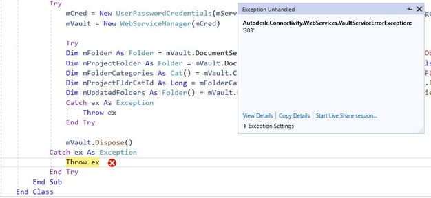

I got this to work in a simple form (click a button and the coded folder is created).
The only bug/error I run into is in the second "Throw ex" (as shown in the printscreen)

Markus.Koechl
The error 303 reflects missing permission for action; you can look-up error codes in the SDK Help searching for the number.
I only can guess what causes the exception, but you could step by step review where it happens; because you are saying that the folder successfully created, I think that the reason is your default category is "Folder," and you try to update the new folder's category to "Folder". If you try the same in the UI, Vault returns the message that the action can't be performed because nothing changed.
