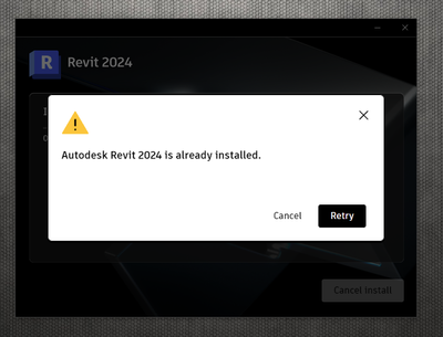

 Hi all,
 I'm installing Revit 2024 but this notification visible ??
 How can i solve this issue ?
 Absolutely, i haven't install it.

Message 5 of 34
One, or both, of the following registry keys would be the most likely cause of a Revit 2024 is already installed message:
HKEY_LOCAL_MACHINE\SOFTWARE\Autodesk\UPI2\{BD020DC3-CB90-42D7-8394-3353483CDEC2}
HKEY_LOCAL_MACHINE\SOFTWARE\Microsoft\Windows\CurrentVersion\Uninstall\{7346B4A0-2400-0510-0000-705C0D862004}

Thanks for the tip to completely uninstall Revit
"One, or both, of the following registry keys would be the most likely cause of a Revit 2024 is already installed message:
HKEY_LOCAL_MACHINE\SOFTWARE\Microsoft\Windows\CurrentVersion\Uninstall\{7346B4A0-2400-0510-0000-705C0D862004}"
This needs to be added to the "How to perform a Clean Uninstall of Autodesk products on Windows" document.  This would have saved me 6 hrs of work.
