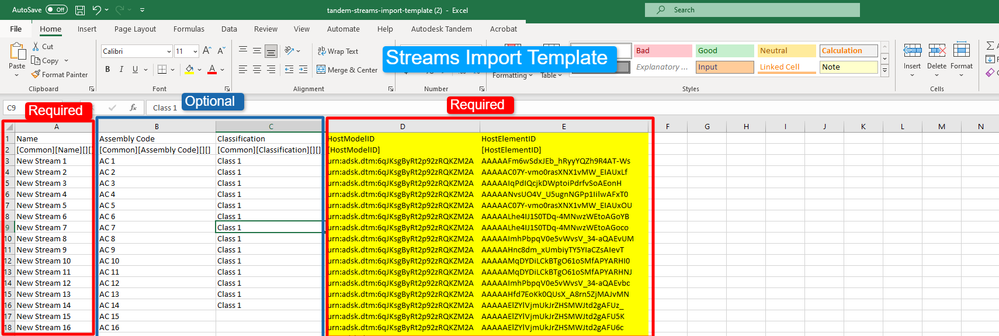

  5. Open the template file (from step 4) and the inventory export (from step 2). In both files, the last two columns are utilized in this workflow. Their column headers correspond to the yellow  highlighted areas in the picture below.
  6. From the inventory export, copy the values from the columns noted in Step 5, and paste them into the Template File.
  7. In the Template File, fill in the Name column; this is required.
    Users can fill in the other two columns if desired, but it is not required to upload.
