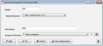

Hi Dave,
Hope you can help me with these queries
  1. If we are modelling composite section (i.e. steel beam and concrete deck) for the main longitudinal member and use the continuous slab to define the transverse properties, is correct for me to say that SBD will calculate automatically the longitudinal bending stiffness using the transformed composite section and the transverse bending stiffness is calculated using the slab thickness?
  2. Is the torsion stiffness also calculated by SBD in the longitudinal direction using full torsional stiffness of the beam plus half torsional stiffness of the slab ( Jlong = JBeam + Jslab/2 ) and the torsional stiffness in the transverse direction would be just from the half of the torsional stiffness of the slab. Is all the above is done automatically without the users input other than assigning the geometry properties?
  3. In the bridge that I am modelling, will SBD calculate the longitudinal bending stiffness of the section using the box section together with the slab and will it calculate the transverse bending based on the top slab only? If not, how should I adjust it manually? (For your information between the box sections there are slabs at the top and bottom, however at cantilever section and on top corbel there is only slab on the top.) I have used the “continuous slab” in SBD to assign slab in locations where I have only top slab. ( model attached)
  4. With regards to the torsional stiffness will SBD calculate it automatically for the longitudinal member (i.e. in longitudinal direction SBD will calculate torsion stiffness using full torsional stiffness of the box section plus half torsional stiffness of the slab ( Jlong = JBeam + Jslab/2 )
  5. In the transverse direction, I have some locations where there is slab on the top and other locations, I have slab both at top and bottom. How do I address the issue of torsion? And where the is only slab on the top and is assigned using continuous slab, will SBD automatic will halve it?
  6. How do I change the section gross properties to the transformed section properties?
  7. How do I assign the self-weight of the section after transforming the section as this will reduce the cross-section area?

Figure 1 :Shows composite section to be assigned to the longitudinal memberFigure 1 :Shows composite section to be assigned to the longitudinal memberFigure 2: Transverse Section properties to be assigned using continuous slabFigure 2: Transverse Section properties to be assigned using continuous slabFigure 3: Shows that the transverse member is assigned as with  2 nos of slab ( top and bottom)Figure 3: Shows that the transverse member is assigned as with 2 nos of slab ( top and bottom)Figure 4: Shows main box section beamFigure 4: Shows main box section beamFigure 5: Shows location where there is only slab at the top ( ie at the corbel and the cantilever /edge  beams)Figure 5: Shows location where there is only slab at the top ( ie at the corbel and the cantilever /edge beams)Figure 6: Why the "type : gross section is greyed-out and cant be changed to transformed section.Figure 6: Why the "type : gross section is greyed-out and cant be changed to transformed section.
