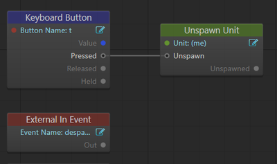

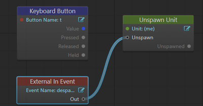

So, I am working on a inventory system, and want to despawn/destroy the unit that the player picks up. However, when I call
stingray.World.destroy_unit(stingray.Application.main_world(), unit)
I get an access violation.
Same thing happens when I try to call the Unspawn Unit flow node via a unit flow eventthis_does_not_work.PNG
but triggering the Unspawn node via a keyboard button works.
And the access violation error message doesn't tell me much.
What's the best way to do this?

Do you have the callstack available?
I'm guessing you've written your own Unspawn Flow node which then does that Lua call and then it crashes?
You need to double check that both params, i.e the world and the unit aren't nil.

I have not written my own Unspawn node, I am using the one available in Unit Flow.
I have checked that both the world and the unit aren't nil, and both of them work in other places of my project.
Here is the callstack and error message from when I am calling
in my inventory script.

 And here is the callstack when I call the Unspawn flow node via an external in event:
Editor / General: Test Engine: Access violation (0xc0000005) in build e643650096712533ea0ade9e638eeb1d671fbb05

Message 4 of 10
It looks like your issue is in
Flow callback: ProjectFlowCallbacks.AimedAtUnit
Are you sure you don't have some dangling unit references somewhere that you try to use in AimedAtUnit ?

Let me try to explain better.
If the player is looking at a key for example, and picks it up and places it in the inventory, I want to despawn the key unit that is in the level.
I have tried despawning the unit in my "insert to selected slot" function, but that gives me an access violation.
Because the unspawn flow node works when it is connected to a keyboard input node, I thought that it might work with an external in event sent from the same function as mentioned above, but that gives me an access violation aswell.
Here's a look at my function where I insert items in my inventory:
