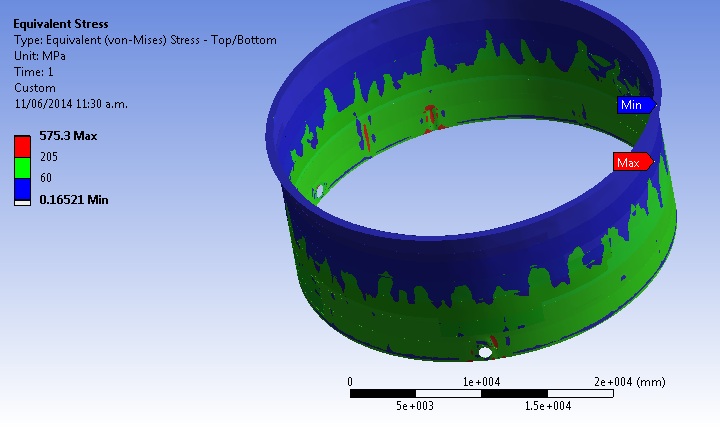

I am doing a simulation of a storage tank. the tank is divided in ring with different thickness and a zone with a internal reinforcement to specific parts of the rings. I have cloud points of the surface of the tanks i processed th cloud ,exported to inventor and then to simulation mechanical. However ,I am having wrong stress values, how i know i upload the same model to other fem software and the stress are totally different we are talking of the twice the values in the deformed zones.with a maximum stress overshooted. in the other fem software I only have high stress values in zones were i dint clean enought the mesh as the place were a pipe is located and thinks like that.

It is not unusual to have a "hot spot" of high stress, depending on the type of elements and the mesh quality. So the fact that the maximum stress is 1130 in Simulation Mechanical and 575 in an unidentified program is not that big of an issue.

I know that part. In the simulation the mesh is stablished in fine. In ansys I try to give the same dimentions.. if you can see in the image the hot spot of ansys is a small zone however the hot spot in autodesk are large zone where the stress over pass 205Mpa yield stress of Asme A283 grade C. This is more than a single hotspot and is more a wrong calculation. The deformation in ansys are between 60 mm and in autodesk are 578mm. My problem is  that i need a real aproximation because i have to evaluated the integrity of the tank.
