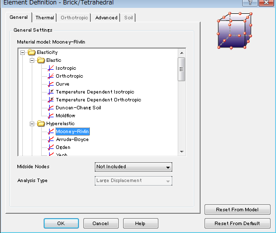

I had a look at your material properties and it looked like the density, bulk modulus and 1st and 2nd constant were the only parameter values added so I made another Hyperelastic Mooney-Rivlin material with your material data values. The model was then able to run for applied displacement of 0.5" (I have yet to test it for displacement of 1").
I will have a further look what parameter not defined in the viscoelastic model is causing the simulation from not converging. But as you did not seem to have placed values in the other parameters, is viscous behaviour something you are currently looking into?

shigeaki.k
Hi Ransi,
thanks for the answer. I wanted to confirm the usage of the material type.
I had a proper look at the parameter settings. Could you try using single core to run the analysis and see if it works for on your side. It seems to work on my side.

RansiDevendra6239
Hi Shigeaki,
I tried single core and it worked.
