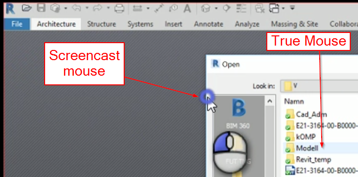

Magnus.B
Thiougt this would have been sorted now a year and a half later but I'm Having the same issues, mouse pointer is way off on 4K screen.
