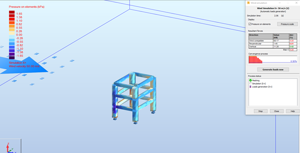

I did two simple wind simulation on Robot Structural analysis, I am getting two different values
1) the first simulation was the same building, wind speed 50 m/s without cladding
2) the second simulation was the same building, wind speed 50m/s, with cladding.
So am posting this message, to know if we should put the cladding before or after the simulation to obtain correct values for wind pressure.
Thanks in advance

Hi @Anonymous
If the wind acts on walls (claddings) then before; if not after Smiley Happy
