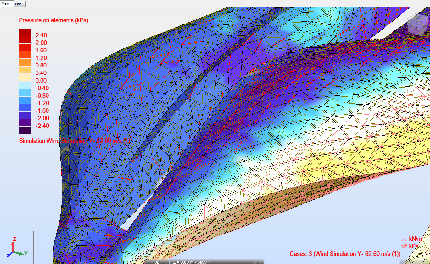

I am currently using the Wind load simulation in Robot 2015 to generate multiple load cases on a number of purely exterior claddings which will later be transferred, to a separate model, to the underlying beams. The simulation is producing edge loads, in addition to UDLs, on some of the cladding panels which are not near the edge of the mesh and I can't understand why?
A screen shot of the generated loads is attached below, line loads are indicated in red.
Any help would be great.
