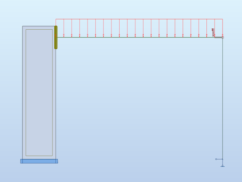

I am trying to wrap my head around how ROBOT works in terms of wall in plane bending. I have a question that I hope someone can help me with.
This is the scheme at hand:
In reinforcement parameters I have put the required deflection and cracking limit. I have changed the calculation method to analytical and ran the analysis. The resulting reinforcement map is something that I would expect.

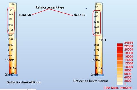

Question: Does robot adjust reinforcement for in plane bending according to given deflection limits in reinforcement parameters? Is there a way to see the final deflection?
Yes it does,
In your example the deflection criteria are not critical.
In this example:

Hmm... I am wondering whether this result is a fluke or not. I have done the same test that you have performed on a beam and got same results on both. This time I made sure to make deflection the limiting factor.
