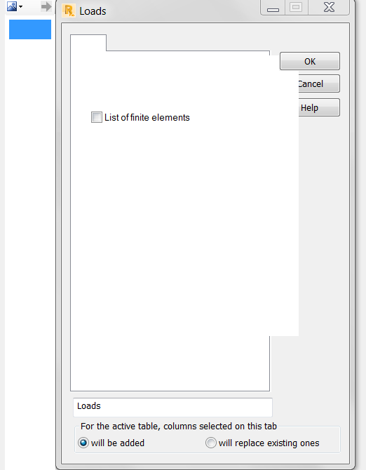

I am currently using Robot 2018 and I have a problem with the visualisation of the context menu (right click -> Table Columns) for Load, Combination and mass tables. I can open and view it with regard to results (e.g., displacements), but when I try to do so in the above mentioned categories it appears as if there is something in front of it covering the box. I also cannot see the load combinations defined either automatically or code-based, and clearly I cannot fix it until I don't see the context menu in the relative table.
I have tried to restart the laptop, opening the same project with two different versions of Robot (2017 and 2018) just to verify if the same problem persists and it does. It is something that suddenly arose so I don't see a particular cause for it.

I have just tried to rename the .dll but unfortunately this just eliminates the side bar, which I would actually like to have and it is not the one overlapping the other box. Unfortunately the problem still persists (as image attached), just without the side bar. Overall, unluckily nothing changed apart from the side bar disappearing.

Thank you again for your help. I have just tried and attached the result. I would tend to say that this is maximum it can get so thank you very much for your time and effort.
