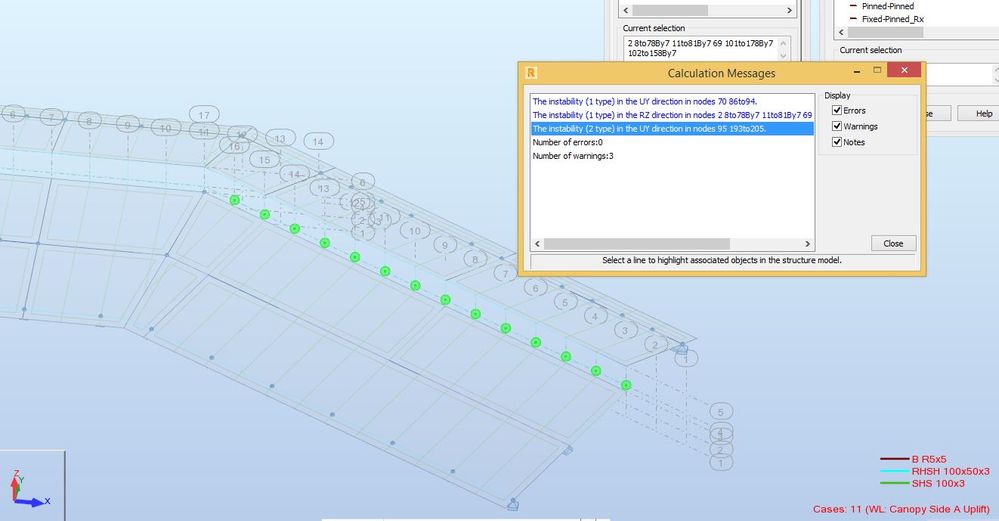

Good morning.
I am designing a roof structure with steel members connecting to a Vierendeel truss which runs along the apex. The truss supports 100x100x3 SHS Roof members. These members are pinned to the truss. The roof cover has been modelled as a cladding material with no properties, purely for load distribution. There are linear pin supports running under panels in the middle of the roof to simulate walls.
I am getting instabilities of type 1 and 2 within the truss, in direction Rz and Uy. I have been unable to resolve it by playing around with the releases.
Any help would be most appreciated!
Rosie

Hi Artur,
Thank you for responding. This did not actually resolve the instability issues, the problem turned out to be that I had defined the vierendeel truss members as 'truss' members which was incorrect as this meant they could only take axial load when they were also required to take bending.

Yes, that would be an alternative to additional bracing for truss bars Smiley Happy
I'm glad you solved this issue.  Good luck with your project.
