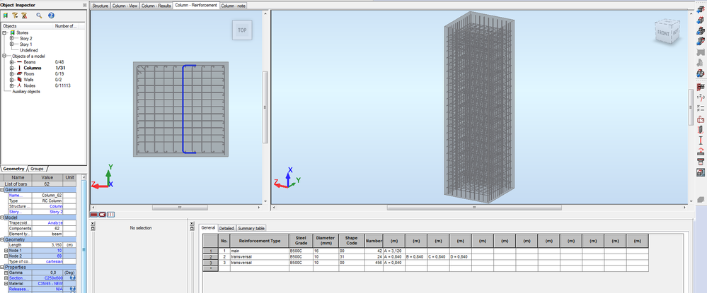

I am designing a 2-storey RC Frame house and most of the columns get the error "Unsatisfactory Load Capacity of the Column" when designing the reinforcement.
one of the columns is 600x250mm, after the error I tried to increase the size of the column (within the provided reinforcement module) to 600x600mm and again i get the same error. ( i did not recalculate the analysis)
i even increased the column to 800x800mm and again i get the same error.
I also tried 900x900mm  and it worked, well i have never seen such a column in a house or even a 5 storey RC frame so something is certainly wrong here.
can someone help me?
below is the design that actually worked..... excessive you say???
The column highlighted is the one being designed no.5

I tried increasing the dimensions of the column only on one side to 900x250mm and now it works.
i will try the same with all columns and see the end result.

Hi @Μηχανικος
My understanding is that you expect the column to be of a smaller size. If so, from my experience usually the issue is not with the RC Design but with the values of internal forces you get for a column. Are they as you expect them to be or larger? Perhaps you should look at the value of the base shear for seismic analysis and compare it to the static force procedure (assuming you defined the response spectra one) or change the supports from fixed to pinned.

Μηχανικος
Instead of changing the support from fixed to pinned dont you think its better to just decrease the stiffness of the fixed support, lets say for example to 80% of the current stiffness.
But you are right though, in real life the supports even in RC frames are never fully fixed.

2. "The results you obtained are for a model as defined. If e.g. it is created in such a way it behaves differently than expected (e.g. missing releases or supports; ignored instability, wrong seismic analysis parameters etc. ) then the column size and its reinforcement will also be different than expected. As you should know the estimated values of forces in the column the question are the obtained values in this range?"
2. The results of the external forces are reasonable, however the results of the internal forces given in the RC Design Module -> Provided Reinforcement -> Column Results Tab are excessive.
could this be due to the layout and behaviour of the structure during an earthquake?
3. "To check if the results of the seismic analysis are in the expected range."
3. Yes the results of the seismic analysis are in the expected range. Below are the checkings i make to ensure that the analysis and input loads are correct.
