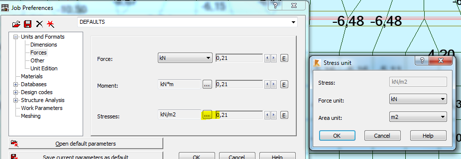

How can we change the settings of P from kn/mm2 to kn/m2?
Artur Kosakowski
hi Artur,
It's still the same.

I'm sorry. You need to set the force to kN and units of structure dimensions to m rather than mm.
