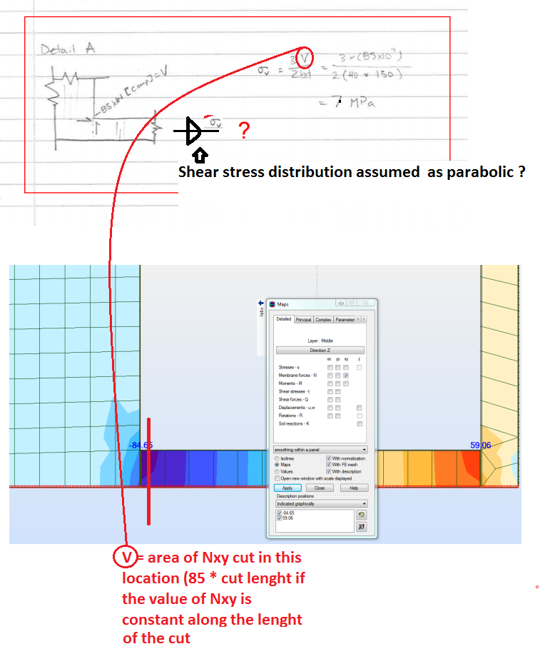

Now that I'm dealing with just this panel, I guess my only concerns are the membrane forces (N). On the simpler side of things, my largest tensile forces are in the Nxx plane, and I've analyzed those as per the attached document. However, the largest compression force are coming out when I select Nxy (the output is also included in the attached PDF). I don't quite understand that particular output or how I'll analyze it.

Nxy is the in-plane shear.

Okay, then is it as simple as the outlined calc in the attached pdf? I have a feeling it's trickier than this...

Thanks Artur,
I did assume a parabolic distribution of shear stress. I realize this requires a constant shear force over that cross section. I appreciate that this may be a small stretch for this particular case, so I will be careful not to make a decision where the demand is too close to capacity. I'm not sure how I would go about evaluating the reality of this assumption though... I think I would need to take a cut through that plane, and examine the shear envelope.
