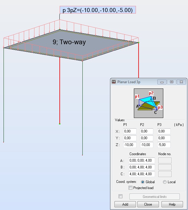

Good Afternoon,
Can we put a surface trapezoidal load on cladding : it starts for 10 and end 5 KN for example over the surface?
Regards,
Gabriel Habib
1,175 Views
Rafal.Gaweda
Autodesk Support
Autodesk Support
Surface loads work on claddings also.
Rafal Gaweda
Can't we put trapezoidal load on the cladding as we can do for bars?
Rafal.Gaweda
Autodesk Support
Autodesk Support
We can :
Rafal Gaweda
