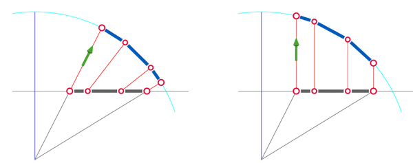

Using the given Excel file, Sphere, it is possible to obtain spherical shapes from simple meshed panels by a translation of the nodes by the API. This gives great freedom of shape and also allows openings.
You will find two methods to perform the shape,
  • the first (Explode checked) projecting the nodes on the sphere,
  • the other (unchecked) moving them up in the direction of the beginning end of the line (axis).
The start point of the line is the center of the sphere and the end is the top. The radius being the difference of the two points.
Best Regards
