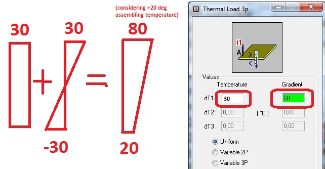

I am trying to apply an 80 degree thermal load to the upper surface of an RC Shell but it won't let me specify a temperature in the "surface > thermal loads" window. I can assign a gradient and apply it to the shell but no temperature.

Sorry for the late reply, I've tried these already... I'm designing a flat RC slab and the option to input a temperature is not available.
I do "load definition", trying both "live" and "temperature" but within both of these the program does not allow me to input a temperature, only a gradient as seen in the image attached.
I wish to apply a temperature of 80 degrees C to the top surface of the slab, I'm designing it within "Plate Design".

 temperature gradient along an element's thickness , along local Z.
Convention:
gradient value -> on top = +half of gradient value , on bottom  = -half of gradient value.

So for a slab thickness 650mm where it is desired to have 80 degrees at the upper surface and 20 at the base.... I would specify a gradient of -60/0.65 = -92.31 oC/m and this will simulate the desired affect?
Message 6 of 28
Rafal.Gaweda
Autodesk Support
Autodesk Support
No,
In such case you have to change structure type on Shell then:
if you consider assembling temperature as 0 deg then:
if you consider assembling temperature as 20 deg then (elements have already temp 20 deg):

Important : message 6 updated \ corrected!

Refaat
Dear Rafal
What is the meaning of  "assembling temperature" and what is the difference between assembling temperature and  the value of  "dT1" in the "thermal load 3p window" ?
Refaat
Message 11 of 28
Rafal.Gaweda
Autodesk Support
Autodesk Support
This is written just above second screen shot in message 6:
"if you consider assembling temperature as 20 deg then (elements have already temp 20 deg):" - it means starting temp is already 20 so you need to "heat it' +30 and gradient 60.

Message 20 of 28
Rafal.Gaweda
Autodesk Support
Autodesk Support
I assume you are refering to second screen shot in post 6
Assembling temperature is the temparature which "already has the panel" so to reach 80 deg on outer fibers you need to add uniform temp of 30 + gradient 60 (which will give 30 on top fibers) so finally on top:  20(assembling ; see text above 80 on screen shot) + 30 uniform + 30 (coming from gradient) gives 80
similar way on bottom
