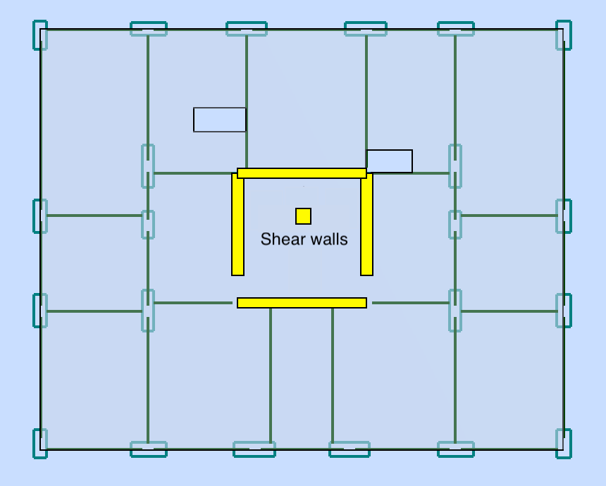

The number of nodes is connected with additional walls as you can see in the model. The first model is moment frame system, the second one was improved/upgraded by adding shear walls in the core of the structure.
In the third type the columns on the shorter edges of the building projection were replaced by shear walls and finally in the fourth type also but in the second direction.
You can try for example change the behavior factor in the 2nd model and you will find that the displacements will change.
Here are the pictures with planar view for the models:
Zrzut ekranu 2018-07-20 o 20.37.26.pngZrzut ekranu 2018-07-20 o 20.39.52.pngZrzut ekranu 2018-07-20 o 20.42.53.pngZrzut ekranu 2018-07-20 o 20.44.00.png
I hope that now the situation is more clear for you but still thanks for the response!
