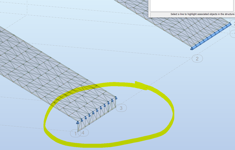

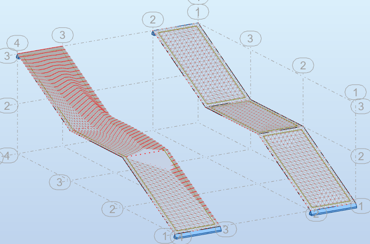

I am currently working on the design of slabless/sawtooth stair design. I have modelled this in 2 ways, both defined as a shell structure. In the first model, I designed the staircase flights as 1 panel with landing as a separate panel. In the second model, I designed all threads and risers as different panels. I expected to have similar results, but as you can see in attached files, the meshing in the first model is completely disrupted and does not follow the geometry as designed.
I am experimenting with different ways that allow best meshing possible so I can determine the minimum thickness for the staircase as this would be the main design feature. An explanation as to why this is happening and how best to model it can be of great help!

For the model "only 3 panels" use Delauney in adnaced meshing option.

Thanks for your reply! I was using the "Delaunay and Kang" parameters in my previous tries. Tried using "Delaunay" only as you showed now, however still got an unpleasant result in my model as per screenshot.

look at what i get
 Try using 0.05 m size

I never thought that is was possible to define a panel like that and get a perfect mesh . In my experience ,a zigzag panel with consecutive  ortogonal planes , the result mesh was always what was displayed on @Anonymous  original model. A weird mesh with Robot trying to build a curved mesh to best represent the input geometry.
Even if you try to get back to the original mesh size(15cm) or change to Conns method , the mesh will remain perfect!!!. And running the model will give no errors at all!!!!
Maybe it is because it was created as a "Floor" object , not as a regular general panel.
Anyway , results on the 2 models with the same mesh size and method are quite different!!.
I would stick with the multiple panels model . I really do not trust 3 panels model although it seems to be perfectly correct with no warnings or errors messages.

I have remeshed model with 3 panels in versions 2021 and 2019 and model looks as expected.
before
after
So in this case reasonable mesh can be obtained.
However I would recommend using single panels for such stairs definition. In my opinion it will be easier to control loads and results when model will be divided into separate panels.

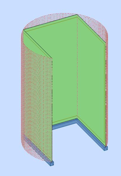

 Regarding model test- one panel version. Mesh will be reasonable when small vertical panel part will be added (otherwise Coons meshing method builds incorrect surface geometry)

@Simau  , I managed to get the exact same mesh ,in your test model, for both single panel and 3 panels using Coons method.
And as a consequence , all types of results are also identical
I tried an U shape wall panel with every  mesh settings possible , but this time , the program generated the expected curved surface mesh
So , right now , I am kind of lost.

Dummy panel definition will help in this case.
But generally contours defined in that way are unpredictable. . When I added point in the middle of central or side walls the following geometry is recognized.
So I would divide model in three flat panels

Thanks for your help! I worked on the inclined plane model by @Simau and managed to get similar results as @Rafacascudo with Coons meshing. A disrupted mesh was what I got initially, however, I solved this when modifying the forcing ratio from "any" to "forced". This way the mesh followed closely the panel as modelled - I believe the extra panel on the bottom edge as suggested in reply 12, would not be required (correct me if I'm missing something! @Krzysztof_Wasik ). The below are the shots I am referring too, and my subsequent results:
