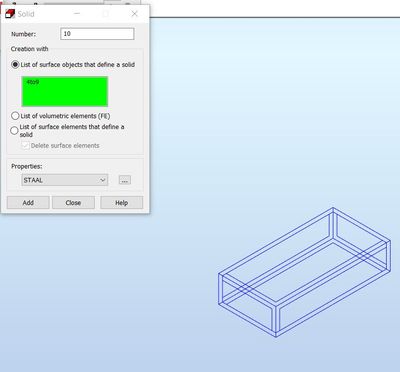

I got another question about solids, in particular if i have to model wood as solids(sometimes nessecary). In the pictures below are the contours which i all have extruded in the same direction.
The connection between 1 and 2 is just easy by using a simple bar between them and copy them a few millimeters in to the solids.(the connection can be seen as a screwed connection, with a little bit of space between the two parts).
But on the side of the extrusion this don’t work(connection between 2 and 3) how should i model this connection.
I’ve tried it with rigid links, and connect these to the front and backside of the extrusion. But this wil give weird stresses at the front and backside.
Or is it better to draw all six sides of the solid and create a solid from them?

Hi @1234eddie
There is no good tool for this type of connections for extruded object side
We can try to divide contours before extrusion (like in attached file) but finally node position should be modified manually
Keep in mind that bar element has 6 degrees of freedom and solid element 3 degrees, so you cannot block bar rotation connecting it with solid elements only

a thought i have: should it work when i draw all six sides of the volumetric object as panels, and create then a solid?
(the only problem i have with this is that the volumetric object is not similar to a normal extruded object? is there something i did wrong?).
See attached pictures in zip file, left created all six sides(volumetric object 12), right created with extrusion(volumetric object 11)

Hi @1234eddie
Using sides for solid creation you will be able to generate nodes at soil surface in desired place (where nodes will be defined) . It will not work inside solid.
Extruded and created from separate faces solids are represented in different way in object inspector.
Extrusion parameters can be modified by Edit >Substructure modification>Object modification while solids created from faces cannot be modified with that option
